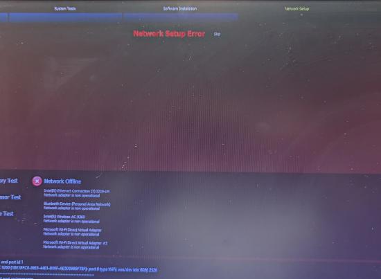

Symptoms/Issue
During an Re-image of a console the console can display the error "Network Setup Error."  This can result in the console not having all the network ports showing up in settings after the re-image is complete.
Fix/Solution
  1. When the "Network Configuration Error" comes up press "Skip"
  2. Let the rest of the re-image process complete
