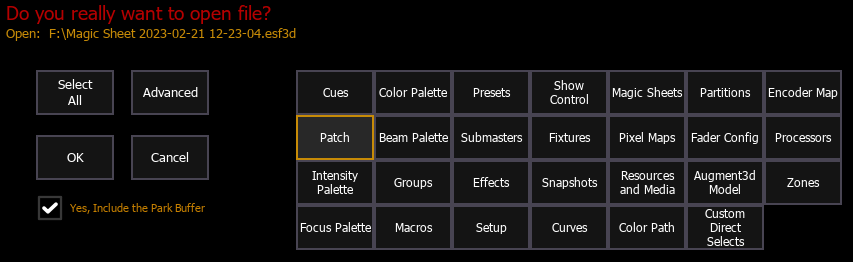

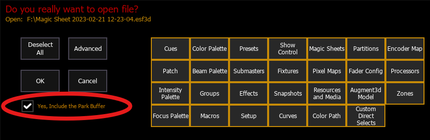

Option 1:
When opening a different show file, be sure to check the box under the OK button on the confirmation screen that says "Yes, include the Park Buffer."  This will bring the parked channels over into the show you are opening and you will continue to have control of all of your fixtures.
Option 2:
If option 1 works, but you want to be able to start fresh in a new showfile, you can use your old, working file to create a new one. Instead of choosing file > new, choose file > open and select the working file. This time when asked if you really want to open the file, deselect everything except the park buffer and patch. Now you'll have an empty file except for those things. You can then save as a new file name. To prevent issues in the future, you may want to use this new file with just patch and park data as a template file.
