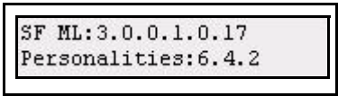

Software Version
You can verify what software version your console is running in the Diagnostics menu.
Menu>Diagnostics>[Software version]
