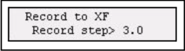

3. Select Record step or Update live step.
Wheel
Record to the next free step
Replace the Live step
Move to step. Adjust step (optional, when recording a new step). This is not necessary when updating the Live step.
Wheel
Selects step to record to. The next free step from the current live step is auto-selected.
