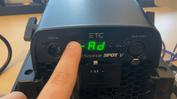

Changing ColorSource V Fixtures to a SHoW Neo ID via Fixture UI
As of fixture software version 1.1.0, to set a Neo ID from a Multiverse ID via the RAD - Id menu of the fixture UI, you can press and hold the down button until the ID reaches 100, then press down again to switch to the Neo IDs and select the desired ID. To get into the menu structure when the fixture does not have signal and is blinking its address, press and hold the menu button until the DMX value is solid, then press and hold for 5 seconds until the menu structure is pulled up. This is not available in software version 1.0.0.

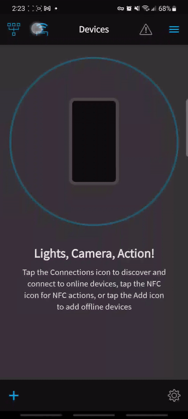

ColorSource multiverse fixtures can be changed to a SHoW DMX Neo ID using the ETC Set Light App with an NFC enabled smartphone.
  • With the app open, pull the configuration from the fixture while holding your smartphone's NFC radio to the NFC tag of the fixture.
  • Make sure the fixture's radio is enabled under the Output Power Level menu. This is set to Off by default, which will disable the radio entirely and disable wireless communications.
  • Change the SHoW ID to a 3 digit number. That number will need to match the SHoW ID of the transmitter. The default for a Multiverse SHoW Baby is 201.
  • Push the configuration to the fixture.

ColorSource Fixtures can only display 3 digits on the UI, so the configuration menu differentiates between SHoW Neo and Multiverse IDs with a flashing prefix.
For Neo IDs, the display will alternate between "nEo" and the three digit ID.
For Multiverse IDs, the display will alternate between the prefix "24" and the three digit ID.  (For some older firmware versions, the prefix will not display and you will only see the three digit ID
