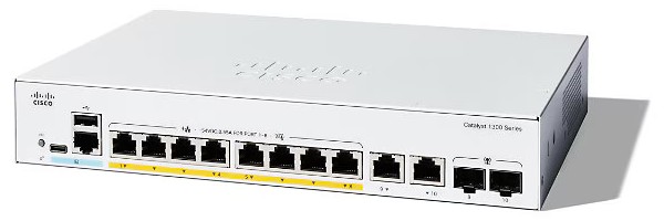

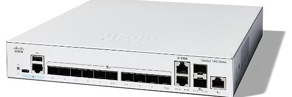

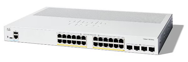

Currently Shipping Switches
ETC PN 4265A1410 4265A1418 4265A1428 4265A1452 4265A1520 4265A1528 4265A1552 4265A1612 4265A1624
Manufacturer Cisco
Mfg PN C1300-8P-E-2G C1300-16P-2G C1300-24P-4G C1300-48P-4G C1300-16P-4X C1300-24P-4X C1300-48P-4X C1300-12XS C1300-24XS
Image n1140.jpg n1142.jpg n1145.jpg n1147.jpg n1143.jpg n1146.jpg n1148.jpg n1141.jpg n1144.jpg
Ship dates May 2025—present
RJ45 ports (PoE)
1G unless noted
8 16 24 48 16 24 48 1* 1*
SFP ports
1G unless noted
- 2 4 4 4 (10G) 4 (10G) 4 (10G) 10 20
Combo ports
1G unless noted
2 - - - - - - 2 (10G) 4 (10G)
Total ports 10 18 28 52 20 28 52 13 25
Console port RJ45 serial, USB-C
Stackable? No Group A† Group B†
Throughput
Gbps
20 36 56 104 112 128 176 240 480
PoE budget
W
67 120 195 375 120 195 375 - -
Rack mounting 1U flush mount
Power supply External Internal
Max power draw
W @ 120VAC
88 152 233 451 158 236 463 24 49
Heat dissipation
BTU/hr
300 521 795 1538 537 804 1579 132 221
Acoustic noise
dB(A) @ 25°C
fanless fanless fanless 37.3 fanless fanless 37.3 29.5 27.6
MTBF
hours
2865360 412959 396413 1662884 426778 337232 1469406 1226587 993232
* RJ45 ports on XS models are for management only and do not supply PoE.
† Switches can only be stacked with other models in the same group. Stackable up to 8 units.
