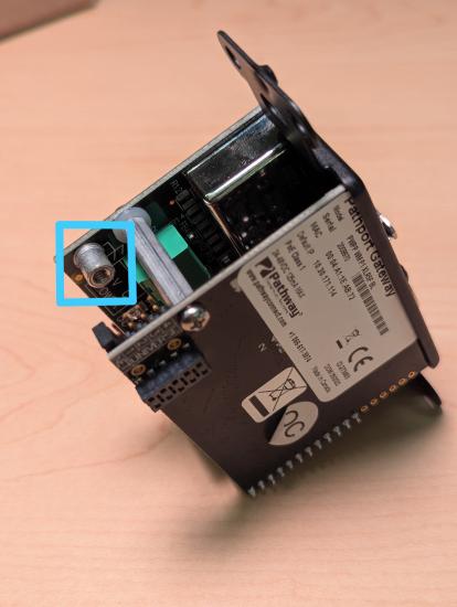

Pathport 1-port gateways by Pathway (ETC P/N SGN1401) may not ship with a ground screw installed. There is a PEM on the circuit board designed to accept a ground screw (shown below).
Pathport 1-port gateway (SGN1401) Ground screw PEM PEM with HW117 installed
The screw used is a 4-40 pan head screw, phillips, galvanized. Length between 1/8" and 3/16" is acceptable.
ETC stocks a suitable screw under the part number HW117 (this one is 3/16" long).
