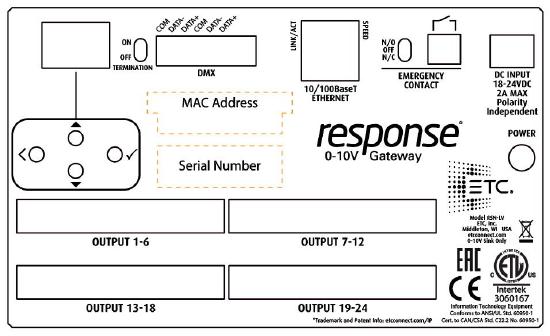

How do I tell the difference between the rev1 Response 0-10 gateway and the rev2
Visual difference between Rev 1 & 2 Response 0-10 Gateway
For one they have different part numbers, but the main visual difference is Rev 1 has a source output voltage adjust in lower right corner, and the Rev 2 does not. The Response logo also has a different font and the ETC Logo is larger.
4267A1002 Rev 1
  1. Does sink and source.
  2. 50ma per output
  3. Has source output voltage adjust knob
  4.
4267A1102 Rev 2
  1. Does sink only.
  2. 500ma per output
