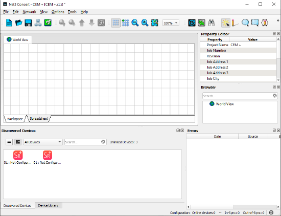

Your racks are online and in a multi-rack system but not yet configured:
You go to send your configurations to your racks by Synchronizing through Concert:
