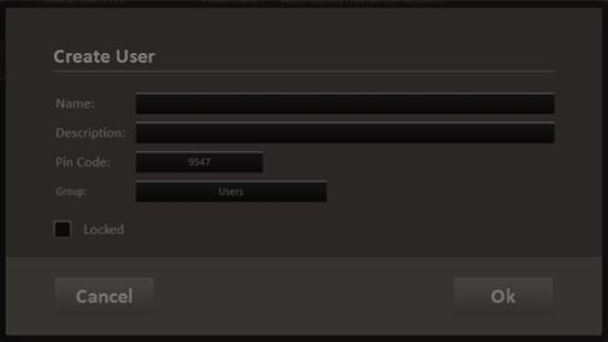

  4. Press "Create" at the bottom of the screen. The "Create User" Screen will open.
  5. Enter a name and, if desired, description for the new user account.
  6. Enter the desired four-digit PIN Code which will be used to access this account.
  7. Choose which group the user account will be classified as.
  8. Press "Ok" to save the changes and create the account.

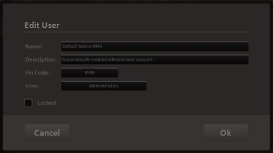

  4. Select the User account you wish to edit and press "Edit" at the bottom of the screen. The "Edit User" window will open.
  5. Make the desired changes to the user account. The "Locked" checkbox can be used to lock out the specified account without deleting it. When checked, this account will remain stored on Foundation, but cannot be used to log in to the system.
  6. Press "Ok" to save the changes.
