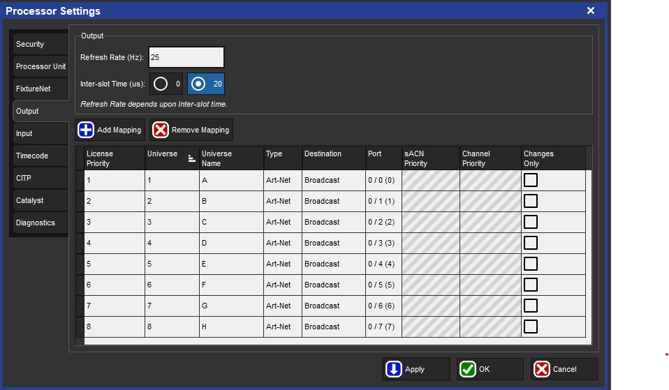

  6. Open the Network window
  7. Select the processor that will be outputting ArtNet
  8. Click on (Settings) in the Network Window
  9. Click on Output tab (Note that if this tab is not present it is highly advised to update your software)
  10. Select Add mapping, Select the starting and ending universe.
  11. Change the Subnet and Univ to match the ArtNet node's subnet and universe settings
    If the node does not give subnet and universe numbers like the Elation Enode 4, then look in the Tips & Tricks section.
  12. Hit (Apply)
If there is a yellow triangle warning in the license priorty columns, then the internal widget or ETCnomad  license that allows for output is not detected
