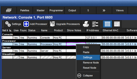

  2. Go into the Network window
    [ SETUP ] ( Network )
  3. Go into the Processor Settings
    1. Right click on the Processor
    2. Click on Settings
  4. Go to the Output tab
