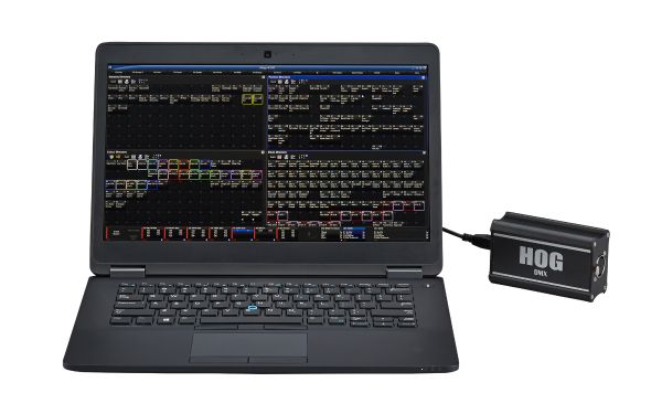

GigHog_center.pngGig Hog with Hog 5 PC
2 36 36 36 YES YES and will add to the number of universes able to control.
  • Maximum number of universes you can control on Hog 5 PC is 12 universes
  • ETC Nomad Keys can be used to unlock universes
PC_Widget_center.jpegHog 5 PC 0 0 0 0 YES YES and will add to the number of universes able to control.
  • Maximum number of universes you can control on Hog 5 PC is 12 universes.

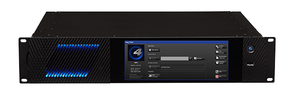

HPU and HPU+
8 64 64 64 YES YES, but will not add to the number of universes able to control.
