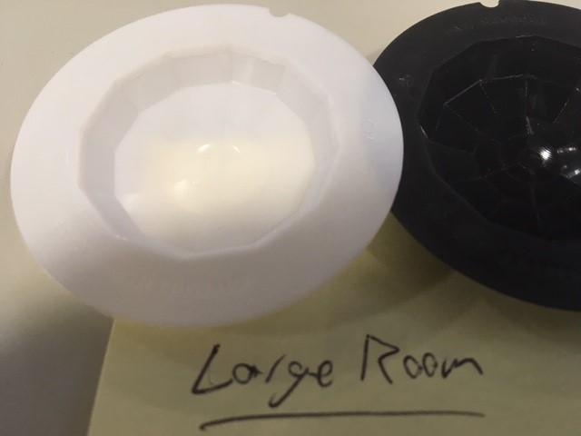

Large Room/2000 sq ft coverage
  • Series of linear striations, may be difficult to see visually but can feel very easily

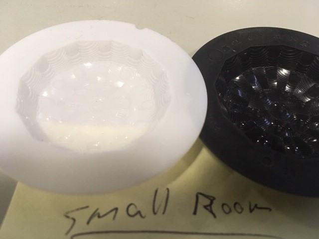

Small Room/500 sq ft coverage
  • Combination of both above, with series of circles with rippling striations
