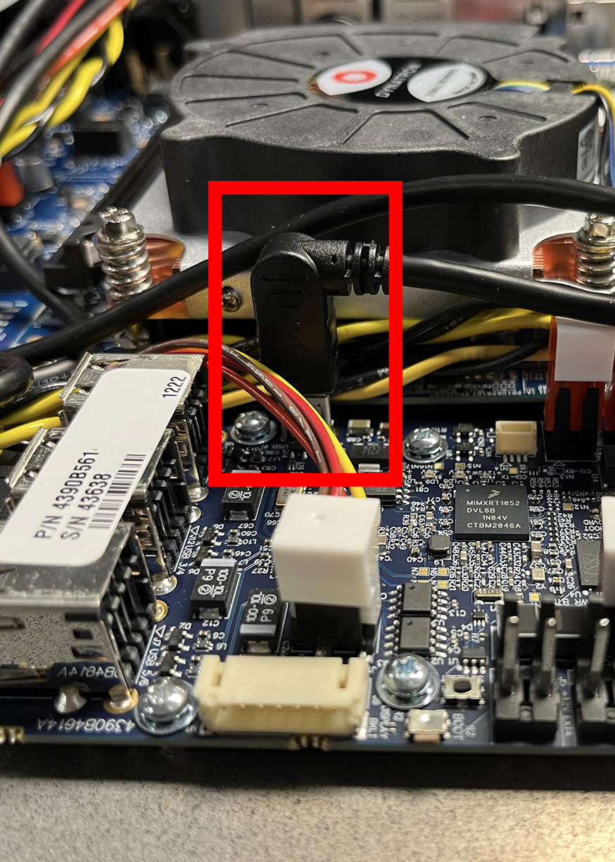

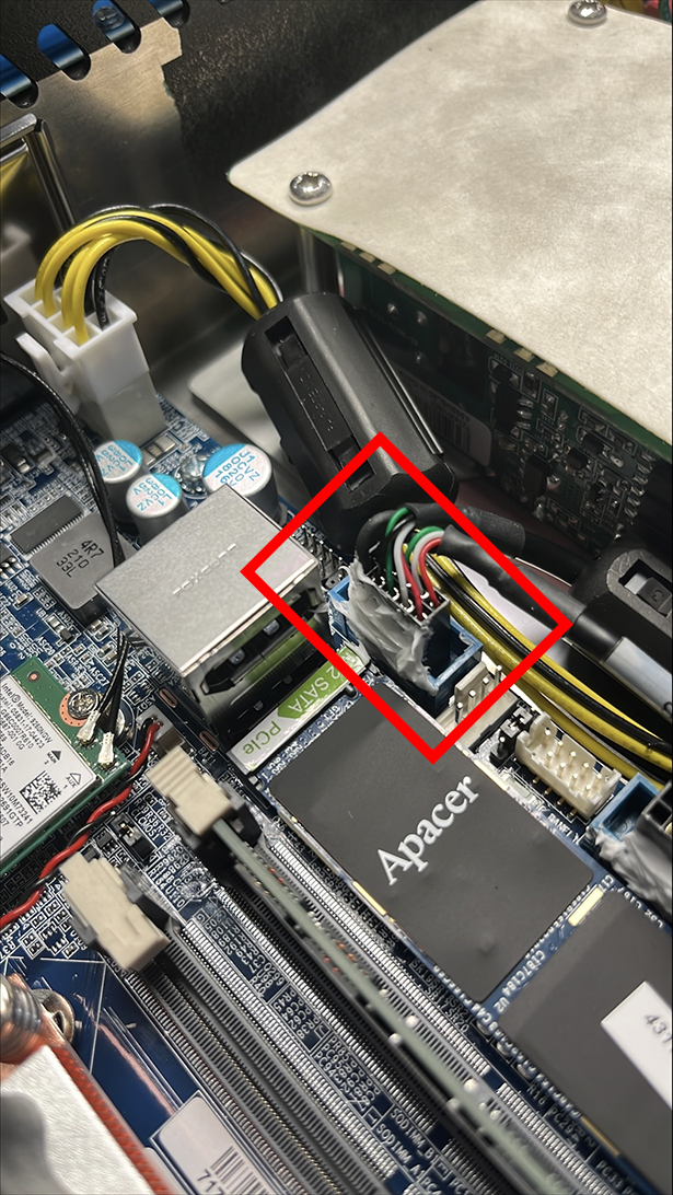

  3. Check the USB connection between the Intelligent Power Board and the mother board. The green box in the image below shows the Intelligent Power Board. The red outlines show the USB connections at the Intelligent Power Board and the Mother Board. When reseating the USB connections at the Mother Board, it is imperative that you put them back in the same orientation and position. Note: There is an adhesive that has been added to the connection to the motherboard on later consoles.
Eos Apex Processor's Intelligent Power Board has a typical USB-A connector on the motherboard
Windows 7 Devices Windows 10 Devices
IonXe_PowerBoard_Callouts.jpg clipboard_eff5b35fcfb4f1ce26725a0f23bc0f112.png
Note: The images above depict the internals of the Ion Xe. The design of the Ion Xe, Ion Xe 20, Ion Xe RPU, and Element 2 will have a similar layout.
