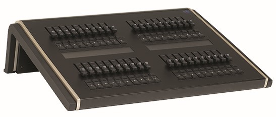

This image shows a Universal Fader Wing. Other types of fader wings are not affected by this issue.
