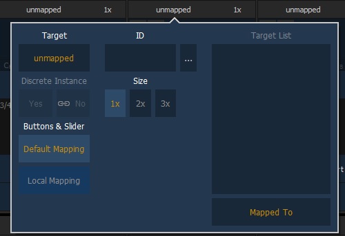

  • Once you have your palettes and presets recorded, open Tab 36 (Fader Config)
  • Locate the fader you want to map to and click ​​the top left corner where it says "unmapped"
  • Click on "Mapped To", located underneath the Target List on the popup window
  • Now type out the palettes and/or presets you would like to record (i.e. Color Palette 1 thru 3 or Beam Palette 7 + Color Palette 2 thru 5 + Preset 17 thru 20) and press [Enter]
