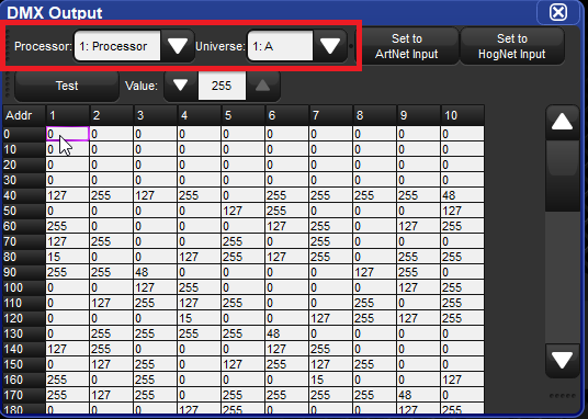

  2. Open the DMX Output window
    1. [ Setup ] ( DMX )
  3. Use the drop down menus at the top of the DMX Output window to select the proper processor and universe

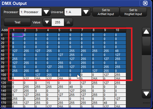

  4. Select the desired DMX channel(s) in the spreadsheet
  5. (Set to ArtNet Input)
  6. This will change the values to red indicating ArtNet input

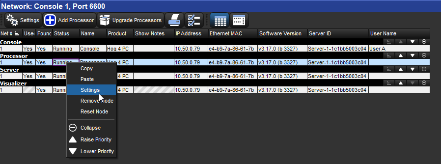

  8. Open the Network window
    1. [ Setup ] ( Network )Open the processor settings
    2. Select the Processor to configure
    3. ( Settings )

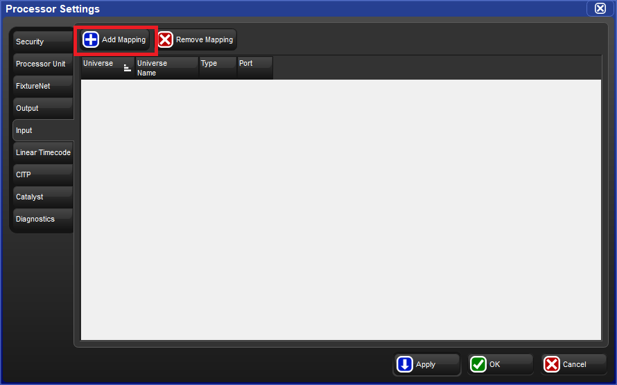

  9. Navigate to Art-Net input tab
  10. Press "Add Mapping" for the universes you wish to input.
  11. On the Hog Universe, set the proper Art-Net universe and subnet. The Art-Net universe and subnet from the Art-Net source will need to be configured to the Art-Net universe and subnet set in this window, Press "OK" when complete
