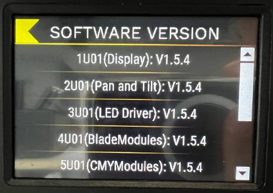

IMPORTANT NOTE: If the fixture update was a success, you will be able to verify the correct software version on each PCB by navigating to Diagnostics → Software Version and scrolling through each PCB in the display menu of the fixture. All PCBs in the fixture should have the same software version.
