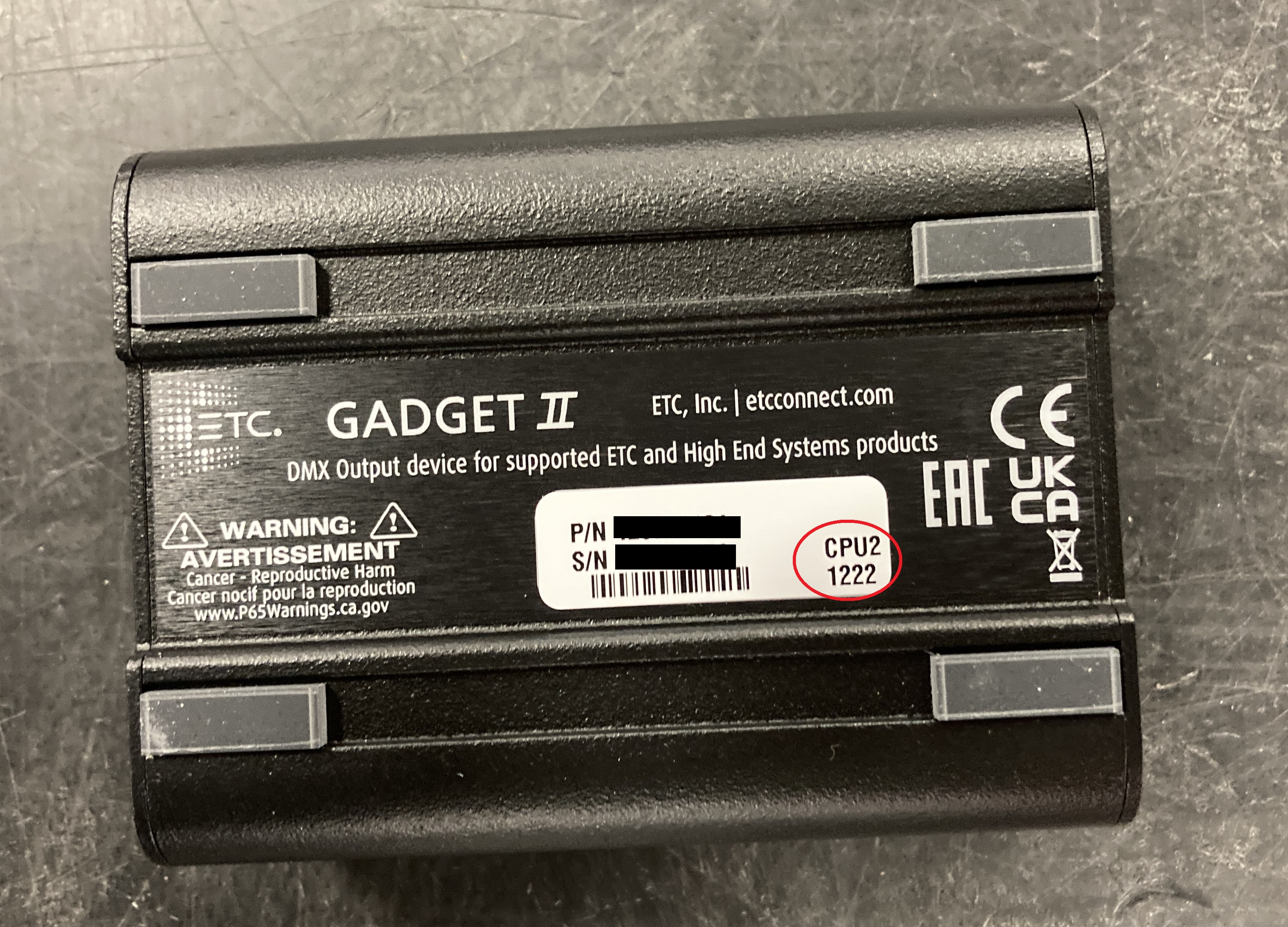

The current solution is to use a non-CPU2 Gadget II with your Cobalt/ Congo System.
How to Know what Version of Gadget I have
